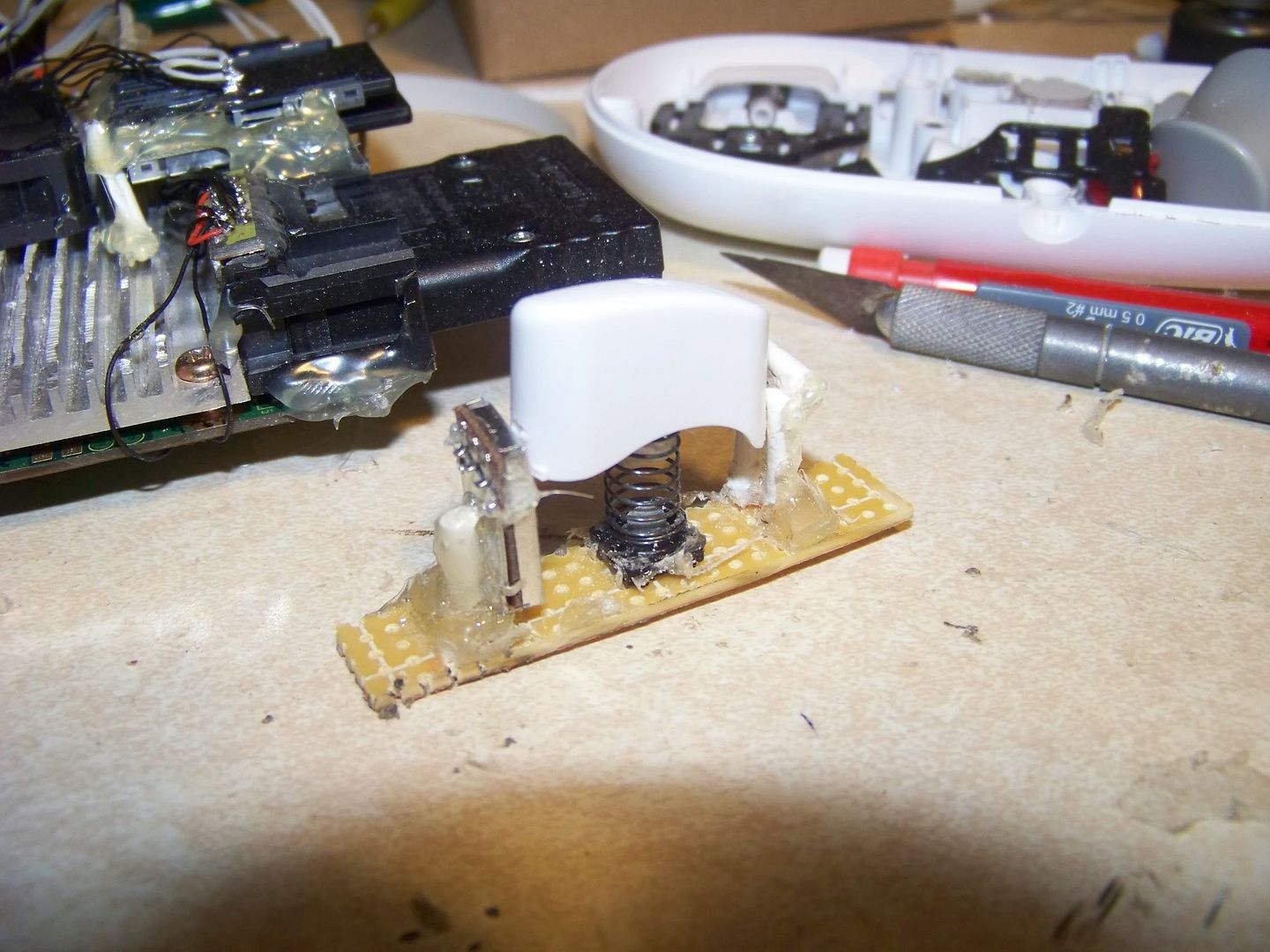

08/09/11
Exactly a month without any new progress, I've solved my trigger problems with full compatibility, full credit for it to hailraizer though,
All I did was use a bic pen and cut it in half, I drilled through it to clear out any ridges. Works really well.
Other than that I've been working on the audio amp and mounted the slot b sd card. as soon as I get my plastic and screen in. Still waiting on custom caps for my psp joysticks. EXCITED TO CATCH UP WITH MY RIVAL!
By the way I'm resizing all my pics to 1024 x 768 for all your small monitors out there.
:trollface:
Re: The phoenix cube BORN FROM THE ASHES OF THE WINGMAN!
Nice job on the triggers man, simple and effective. How is that fan setup working with your trimmed heat sink? Do you have the fan pulling the air away or blowing onto it? I ask because the fusion micro will be similar, but I haven't gotten round to testing it yet. I plan to have my fans pulling the air away.
Blowing onto now, it works cooler like that, I'm going to try sucking the air away later though, the blowing is a bit loud.
