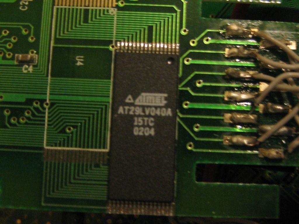

Dude! I'm so happy to see you're getting this far! I can't wait to see this done!
Epoxy those wires down before they give you problems! :awesome:
Also, if you could, give me the chip number of the one labeled ATMEL on your memory card.
