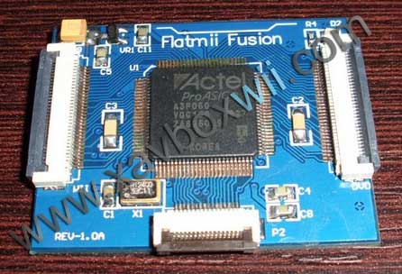

The whole thing might be a moot point though, Foundmy FINALLY shipped out my Flatmii Fusion. So if that chip actually worksand works better than the wiikey does, well then *Can'tSayThisOnTV* the Wiikey. :D
I can't find any good info on the flatmii. How does it work? Same as the wiikey? You solder up the pins to the DD pins of the mobo and then use ISO from an SD card???
Yea, it takes Micro SD cards and has a screen to select games sorta like the WODE:
I'm sure it will fit. But its probably not compatible. I'll let everyone know if it works once mine gets here.
If not, it would only be due to a different pinout. They are probably close though, meaning we could probably get it to work just by cutting some traces and rewiring them.
Or if it's ridiculous just straight up wiring a slot would be easier.

Yea, I'm curious to see if the chip has a "GC Loader" like the wiikey and WODE do, or if it only has the little screen to select iso's from. Hopefully it has a loader so we can ditch the little screen.
