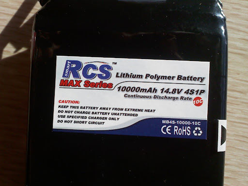

Battery showed up today. Everything seems well and good. Charger and protection circuit should be here monday. Ive got the plastic for my case, and I am very happy with where I am at software-wise. Pics and such tonight. Maybe.
Alrighty. Picture time:
Its sitting on my styrene, which, surprisingly, was exactly what I was gonna get from McMaster, but they had it at my local Ace when I picked up some dremel attachments. Slightly more expensive, but very convenient.
Oh, did I mention that this battery weighs 2 pounds, 4 ounces?
I saw the first pic and I was like, "Oh, that battery looks pretty small." Then I saw the second and I was like "Holy flax that's a big ass battery!"
Holy flax. That was, quite literally, the hardest soldering I have ever done. I had my soldering iron all the way up (45 watt) and it was all I could do to get the tabs apart. Didnt help that the little PCB all the tabs hooked to made it really hard to maneuver without shorting out on the iron. My tip is a little oxidized, but nothing so horrible. Still, I'm getting new tips this week. Unfortunately, ratshack doesnt carry Hakko tips. Whatever.

I saw the first pic and I was like, "Oh, that battery looks pretty small." Then I saw the second and I was like "Holy flux that's a big ass battery!"
They are huge. But, you cant argue with the capacity or price. Plus its really nice that theres only 4 cells. And they are absolutely perfect in size for integration into my case design. they simply make it it thicker by just a wee bit more than 1/2".
Nice. Man, I can't wait to see your design. Mine is turning out HUGE because of the stuff I'm using. Yours is going to be, you know, portable. Whereas mine is going to be... toteable? Luggable? Heh. Do you have a general idea of how big yours will be? Maybe in relation to other portables? Mine is like, the size of the hugest gamecube portables you may have seen. Perhaps bigger (yes really).
A very tentative measurement puts it at about 9x5x2.5". However its not a full brick. The PC, which, currently is about 1" thick, and 5"x7" will be on the back, ala cartslot. The 2.5" thickness includes that. Additionally, I havent pulled my controller apart to see what is inside yet, and I dont have my battery protection circuit yet, so that size may not b entirely accurate. I also think I can shave nearly a 1/4" off the PC's thickness. Hopefully I will have all that ironed out by tuesday.

Posting from it running on battery right now. Running both screen (which runs fine on ~15v) and PC. Gonna play some Mass Effect now to see what I can see.
Bit of an odd thing though. When I first wired it up, it refused to turn on. wouldnt give voltage off the load pins on the PCB. I assumed it was because it needed load to output. However, My PC, like all, doesnt power on when plugged in. It uses a momentary tact for power. I couldnt get it to turn on. So then I dicked with it a bit, hardwired the screen, which didnt work either, etc. Then I hooked my screen to B+ just to make sure it worked on the voltage. Then when I rewired to P+, everything worked. I dont get it. Anyways, it works now, so I am happy.
