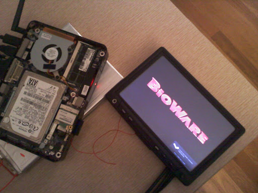

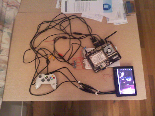

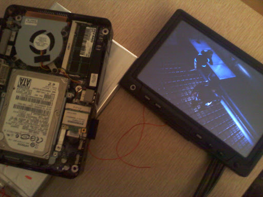

I only have my Cell at the moment, so Pictures will Have to do for now. I'll try and get a camera soonish so I can take some videoage. I'll upload some pictures in a moment. First, i gotta move this thing off my desk so it is actually visible that Its running on batteries.
Also, past 2 hours in ME2, and still going strong.

Are you going to leave the connectors like that or solder to the board?
Soldered to the board, of course. And the batteries will be rewired in a much more minimalistic fashion. I should start fabricating the case tomorrow, but I'll probably end up playing games the whole day, as I need to do a battery life test with a full charge.
It just got almost exactly 3 hours of Mass Effect 2 on the charge it had when it arrived. That bodes very well.

So you got 3 hours? Did you measure the power draw? I bet you can get at least 5 or 6 hours out of it with a full charge. My laptop's battery is about 1/3rd the capacity of your battery and it'll go about an hour while gaming with a ton more computing power.
Battery life testing complete. 4 hours, 45 minutes of Mass Effect 2. Which runs my system harder than anything else, by like 30% system load. Meaning I could get like 6 hours on a less intense game, and maybe more on something like Audiosurf. That battery was worth every penny I payed, for sure.
