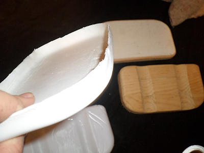

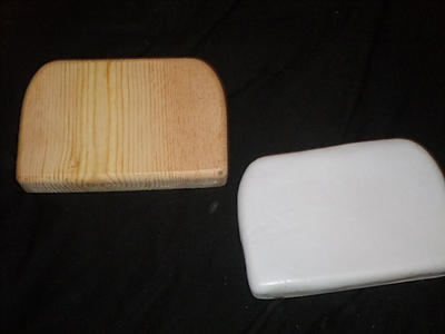

I have never vacuum-formed anything before, so I attempted to with this wood form of the back half of the AG-85 shell. My vacuum was not strong enough and it really didn't do anything. I ended up just heating the plastic with a heatgun and holding over the form with a pair of gloves.
1a4542_b29a04d9e4a747bfa690c858bbdc6c39.jpg_srz_p_400_300_75_22_0.50_1.20_0.00_jpg_srz

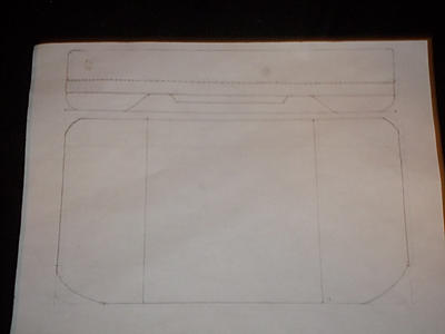

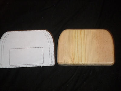

Gotta say, this was not my best work. I just wanted to get a feel of the case's size and see if I liked it. I didn't really though. Are there any other cases that have been used? I like longer cases, kind of like the ZN-40 and ZN-45 but I like the curves of the AG-85. I decided to create my own design by combining these three.
1a4542_f27a15029b2649aaa194d05b344ea691.jpg_srz_p_400_300_75_22_0.50_1.20_0.00_jpg_srz

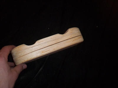

I love this design. I made the wood mold in two pieces and I vacuum-formed it. This time I borrowed a shop-vac and dug up my old coil heater. This made the forming MUCH easier.
1a4542_3751e05726a443b281f61ce84e1ea19d.jpg_srz_p_400_300_75_22_0.50_1.20_0.00_jpg_srz
1a4542_1dee8b5dcfd142ca874bb037815a47d8.jpg_srz_p_400_300_75_22_0.50_1.20_0.00_jpg_srz
1a4542_1fd5d5b773724fc58f7c0e368f001629.jpg_srz_p_400_300_75_22_0.50_1.20_0.00_jpg_srz
I have heard that polystyrene is the best for these cases. The plastic I have that I used for these forms is definitely not polystyrene and it does not have as much rigidity. I have ordered a few sheets of .20" polystyrene to remake these case halves again. Will this be thick enough for the case?

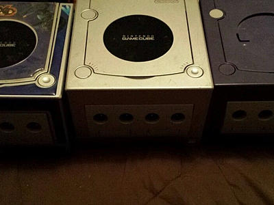

My GameCubes arrived in the mail today, along with the wires I ordered to test them. I got three consoles that were labeled "as is" and they all apparently powered up. I didn't even check if they were the newer model GameCubes or not. They were such a good price I couldn't resist.
Anyway, I plugged them all in and they all powered up as promised. The disc trays all spin. The only problem is, none of them have video!
I am going to go double check on another television to make sure it wasn't just my television's fault. I got a brand new AV cable that arrived today as well, so that isn't the problem.
If worst comes to worst, and these consoles don't work (and are not fixable), I will sell them individually on eBay "As Is" and try to make my money back. I got three of them for $25.00 total, shipped. It shouldn't be too hard to make up that money.
Good news! They all work fine. I tried them out on another Television and they all power up. They all go to the disc menu, and two of them read discs. One of them does not spin at all. I will have to look into it further, but ones enough for now anyway.
Now to start my portable!
These are the three consoles I got:

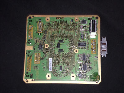

I took one of the consoles apart and I prepared the motherboard for use. I think it is a pretty small motherboard to start with.
1a4542_204b3b8703d0422aa6ade0bc4211857d.jpg_srz_p_400_300_75_22_0.50_1.20_0.00_jpg_srz
1a4542_bbaf76acda9e47448ff34eb62054e26c.jpg_srz_p_400_300_75_22_0.50_1.20_0.00_jpg_srz

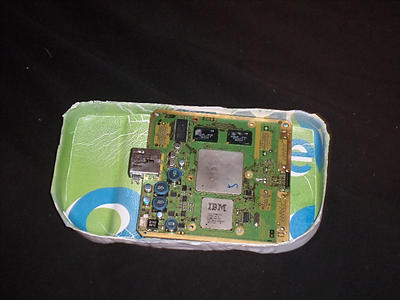

This is it sitting in my mock case, I think it will be fine. I am going to trim off as much shielding as I can, but I like the shape and size of my case so I don't need to trim much of the board.
1a4542_2c7244bce3894079bfba9cc1f396ab68.jpg_srz_p_400_300_75_22_0.50_1.20_0.00_jpg_srz
