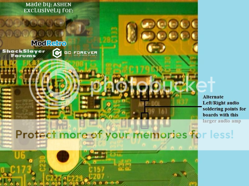

Can someone explain to me why after I trim a gamecube, and don't relocate the 12v sound spot, the audio still works fine?
I've only tried it on 2 gamecubes and both worked. One was an ntsc omgwtf gamecube. The other a pal maximum trim (It's more like an almostwtf but I cut around the original dd pins so i could wire to there). I wired audio from the chip that's next to the big video chip.
The pre-amp? You're probably not wiring to the outputs. Rather the inputs from the "big video chip". If you've cut the 12v trace, you definitely won't get sound from the outputs of the pre-amp.
The gamecube is running off of batteries and 7.4v is not connected to the sound cap. Audio sounds fine.
I wired it here

Those pins on the amp chip are the same as the one on the av chip. So actually you are not using the preamp (which certainly doesn t work).

Those are inputs from the AV chip. You're not actually using the pre-amp wiring there. Pins 7 and 14 are the outputs.
