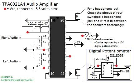

Well emarassingly enough after some mistakes were caught and some degradation in quality over time I've decided to go back with the original components recommended by TI. I'm 99.9% sure that this diagram is error free and will give you the highest quality audio amp that this IC can deliver. Plus the option of a digital potentiometer for button pushing rather than using a massive chunky potentiometer to adjust the sound.
Capacitors are in micro farads. (µF)
SS used a 5 pin 10k pot from radioshack and it shorted out a gamecube momentarily, don't use those.
Try even a 15k pot if you want better volume control.
