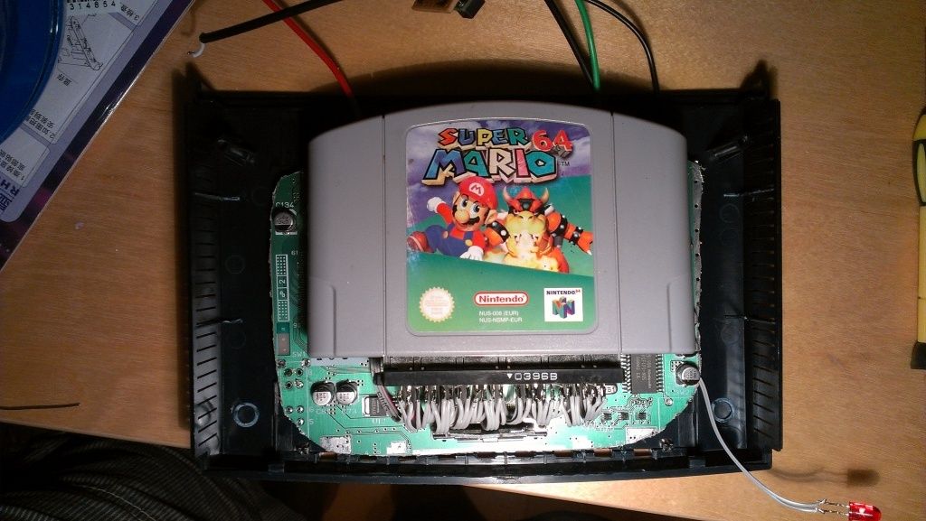

I took apart my first N64p to make a new better one.
Case:
It was going to be for my PS1p but ended up being to small
Cart slot relocated and working :)
I just spent 2,5 hours relocating this thing and it worked on first try :mrgreen:
Its a PAL 03-1 board. I was reading about U8 wiring and looked at my board and cant find it. If someone can point it out, that would be great :)
More updates tonight

Re: Second64 worklog
I have trimmed the board down and rewired some stuff like the led. Now it fits in my case :)
You don't have a U8 chip, your board has a single buffer for each data line. You can get player 1 data from PIF 15.
It has individual buffer chips, you can see them there. What revision board is that?

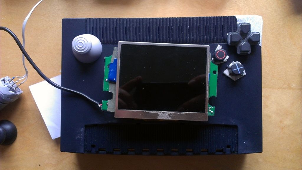

Mockup of my case
I using ps1 buttons because I have alot of them :)
They will be painted in the right colors.

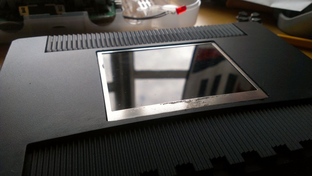

Now I'm off to cut my screenhole
EDIT: Screenhole is cut!

Very clean cut on that screen hole, man! This looks like it's going to be good :awesome:

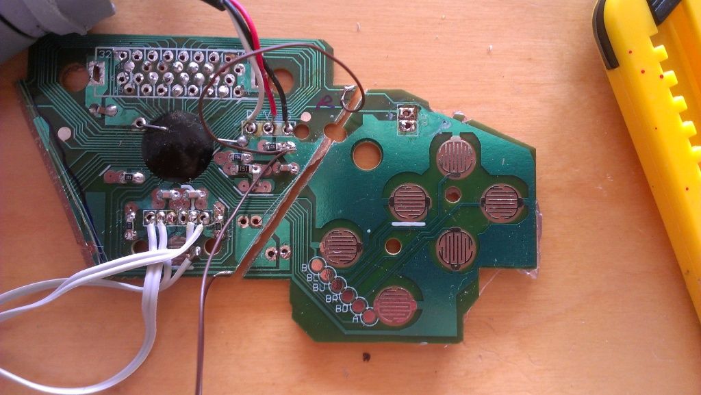

The controllers doesn't look quite as pretty, but hopefully it will after some filling and sanding :)

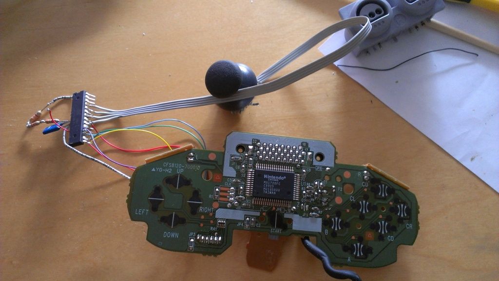

I cut my controller in half last night. Now it doesn't work :wtf:
I didn't wire up ground with the lower brown wire at first and turned on my N64. Thats bad right? Now it just says "no controller". The controller port is working with my other controller.

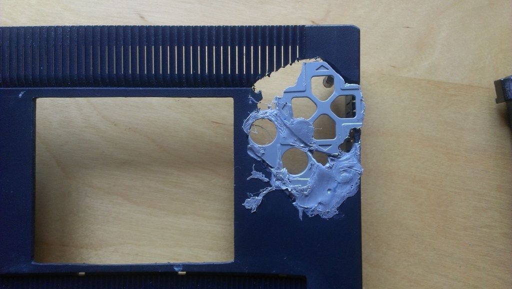

Also, I ABS'ed in the analog stick hole
I think my last controller got fried when i didn't relocate ground... :? Lesson learned.
Now am I instead using a firstparty controller! However with a flashed atmega8a microcontroller that lets me use a PSX stick. The stickclick will act as start
I also filled up the holes in my case. Still needs a lot of sanding though.

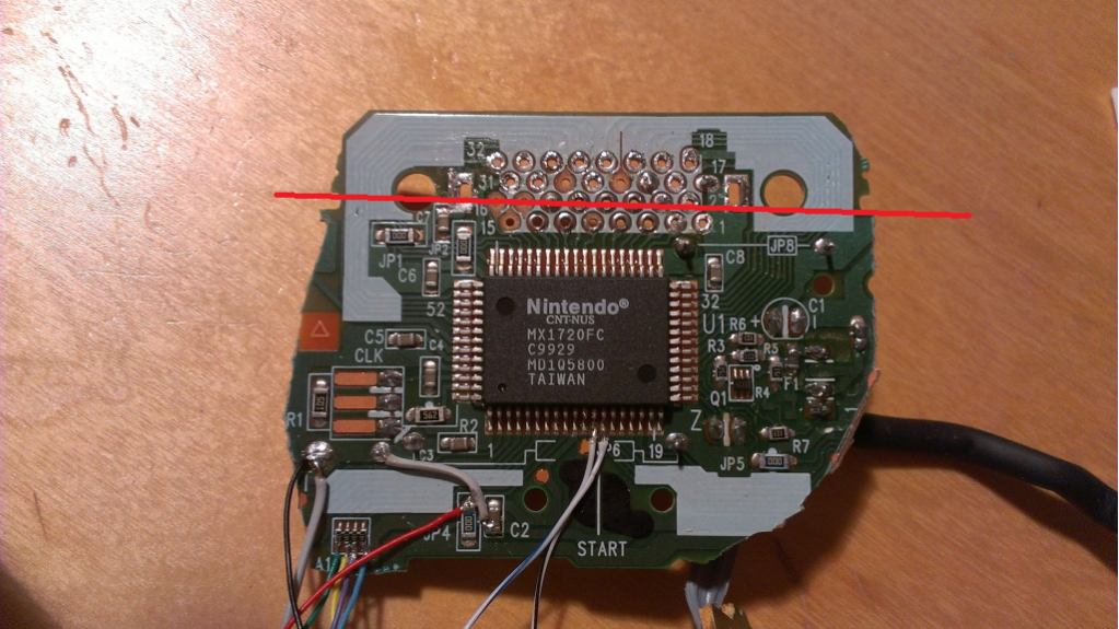

Is it cool to cut the traces to the exp. slot?
How about those capasitors and bridges just below the line? My case is getting much smaller than I first expected :lol:

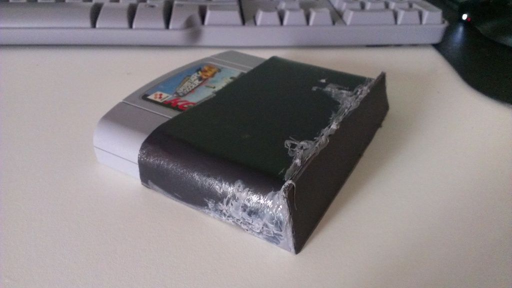

I need a cover for my cart. Anyone have a suggestion on how to make one? :)

I still wonder if the traces for the controllers exp. slot is okay to cut?
Cutting off that part of the slot is fine. You may need to to reconnect ground across the board after the cut.
Here's my suggestion, try to find an old DVD drive that's a little bigger than a n64 cartridge, take all of the electronics out, cut it shorter if needed, and use that as your cart cover.

:D Made out of plastic from the tophalf of a laptop.
