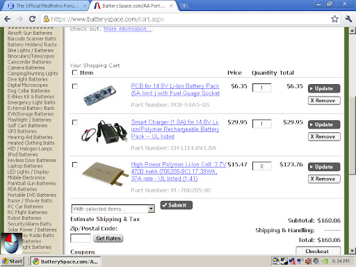

$160? Whoa. What kind of batteries does that get you?
Badass ones, I'm sure.
Thats what I am thinking at the moment. I may change it later, but those cells have the highest energy density of any I've ever seen, which makes em great.

[big fat-ass screen shot here]
And the're freakin' small! So your gonna' get two sets of four in series, and then put the two sets together in parallel?
That equals about 12.97 volts and 9400 mAh.
Just a wiring idea.
Just a wiring idea.
Your math is wrong, but yes.
3.7 x 4 = 14.8.

samjc3 said:
Kyosho said:
Ah, nice. You should get a pretty good amount of battery time out of those.
Roundways 2 1/2 or 3 hours, I think. its plenty for my purposes.
Wait, 14.8v and 9400mAh? That's 139wh, isn't that enough to run a beast of a laptop for that long?
