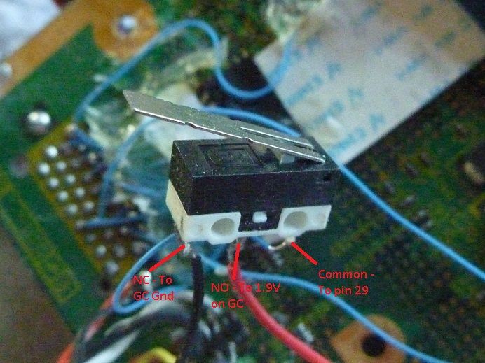

So basically, I am in the mist of creating a gamecube portable but right now i am in the gathering of materials and design planning stages of this. With that said, I have decided to use a wiikey fusion with my portable and Ashen's portable design (If that is okay ;)) and I had a few questions regarding the Wiikey. First off, I am aware that there are regular wiikey fusions, and clones. How do these two wiikeys compare? Is there any difference? Also, could someone post a link to where to buy a wiikey fusion because, I know I have found some websites with them, I just don't know which one to trust with my information so someone experienced in this would be helpful. Lastly, I also know that for the wiikey, to need to simulate that the disk drive is connected, and you achieve that by using a three-way switch. Would this switch work for this...

This is a three way on-off switch and I wouldn't be using this exact one but one similar of its kind. I was just wondering if I could use this one, compared to this one...http://i1068.photobucket.com/albums/u46 ... guide4.jpg

Yup, third party wiikeys work the same as normal wiikeys. Modchipsdirect is fantastic site to buy them from.
oh so your saying that you can use a tact switch, just as long as there are three pins to connecting GC Ground, 1.9v regulator, and pin 29? Am i right one this because I didn't totally understand the wording of what you just said...and also im talking about the wiikey button that simulates it being open. Im not talking about the lid switch just incase if we weren't on the right page here. Sorry but im relatively new at this and i am learning. Just doing my best :)
