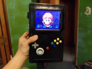

This is my new N64p. I have worked on it off and on for about 7 months now and am finally finished. Here are some of its features:
Zenith Screen, unmodded
9v 5400mAh battery (4 hours)
a/v out port
1st and 2nd player controller ports, with 1st player switch
super pad controller
DC-96P case from polycase.com
Tell me what you think!

Pretty nice for a first portable! It's a little big and I don't like portraits, but it's not huge, and to be fair portrait has a lot of advantages. There are lots of niggly things I don't like though. The mono audio and weird shoulder buttons kind of turn me off. Jumper pak is bleh, but after trying to find expansion paks for a decent price I can see why you used one. On the bright side, I think the battery is really neat. How exactly did you hold it in? It's a pretty nice job for a first portable, and if you do another one it'll probably be pretty good, period.
Thanks for the compliments.
The jumper pak I only used to save battery life. The only thing I don't really like about it is yes, it is really big. But I was a noob when I started and I'm sure my future projects will be better. The audio in the actual system is stereo, I just decided to wire it mono for the a/v out because I already had a cable and plugs for just composite video and mono audio (I don't know how to say that - just the white and yellow plug) so since I'm rarely going to be hooking it up to a regular tv anyway i thought I'd save money by not buying extra parts. but yeah, the audio inside the actual portable is stereo. The battery I do like because I plan on getting another one just like it so I can be playing on one and charging the other. As it turned out, it being plugged in and wedged into the slot that I cut for it was enough to hold it in place and keep it from slipping out while playing, and be able to take out easily. As for the triggers, I didn't know if my idea would turn out or not, but when I finished I was surprised how perfectly it fit into my hand. If you held it you would see what I mean. I'm not unhappy with it at all.
