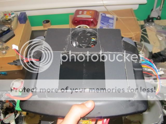

Oh god, please don't leave exposed wires like that. Make a cover that attaches with velcro or magnets. Everyone loves magnets.
As far as battery connections go, I don't have to many options. There will probably be at least some exposed wires just because of the fact that my battery pack is removable. But I will do my best to hide them :) They aren't in their final positions right now anyway.
And thanks! I thought it would be a good idea to help direct the airflow through the heat sink instead of it going out the top of it. I will also add another fan to help direct to air to the heat sink
