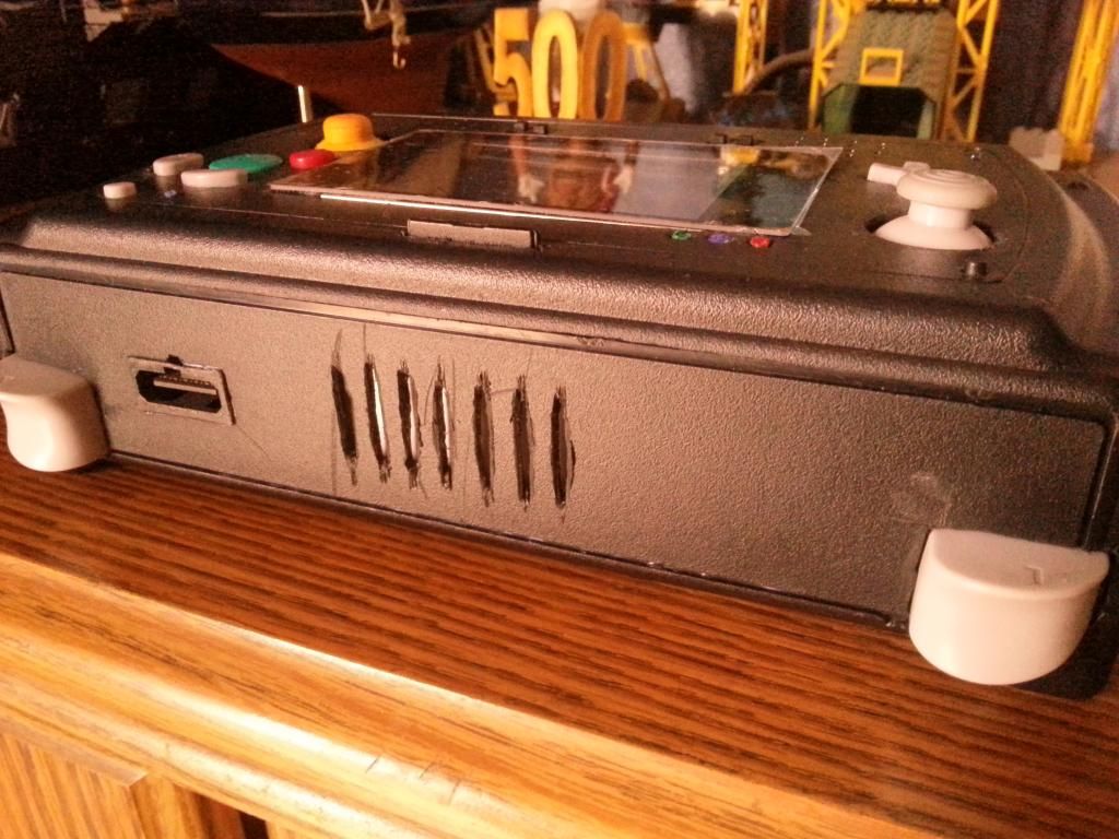

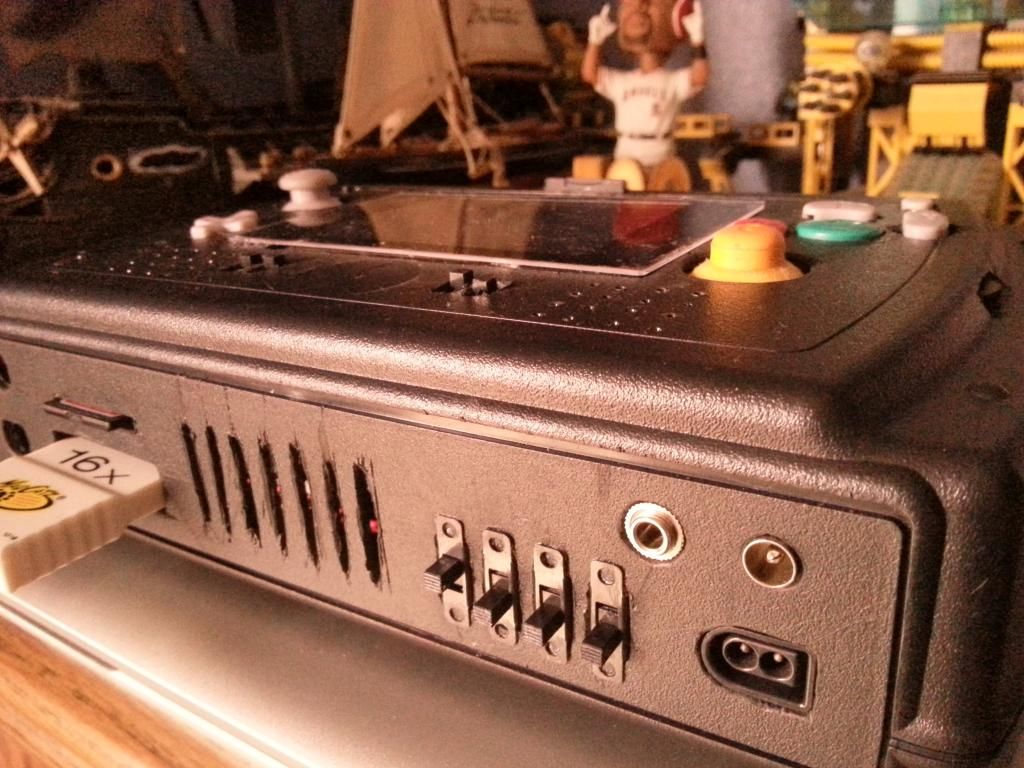

Hello everyone, I'm new here but I've been around researching for my portable gamecube project which i have just finished. It's not the best but I works for me.
(also posted on gc-forever)
specs:
3.5in ebay screen
official gamecube controller, slightly cut, no rumble
rev a/b motherboard, golden border cut to make room for sd slot
custom regulators, not sure if i needed them but there there
4x Panasonic 3400mAh batteries wired for 7.4v
low battery indicator, not sure when it comes on...
wasp fusion & megadrive v3
sd gecko, it actually doesn't work, it's just an sd card holder
memory card slot A
a/v out

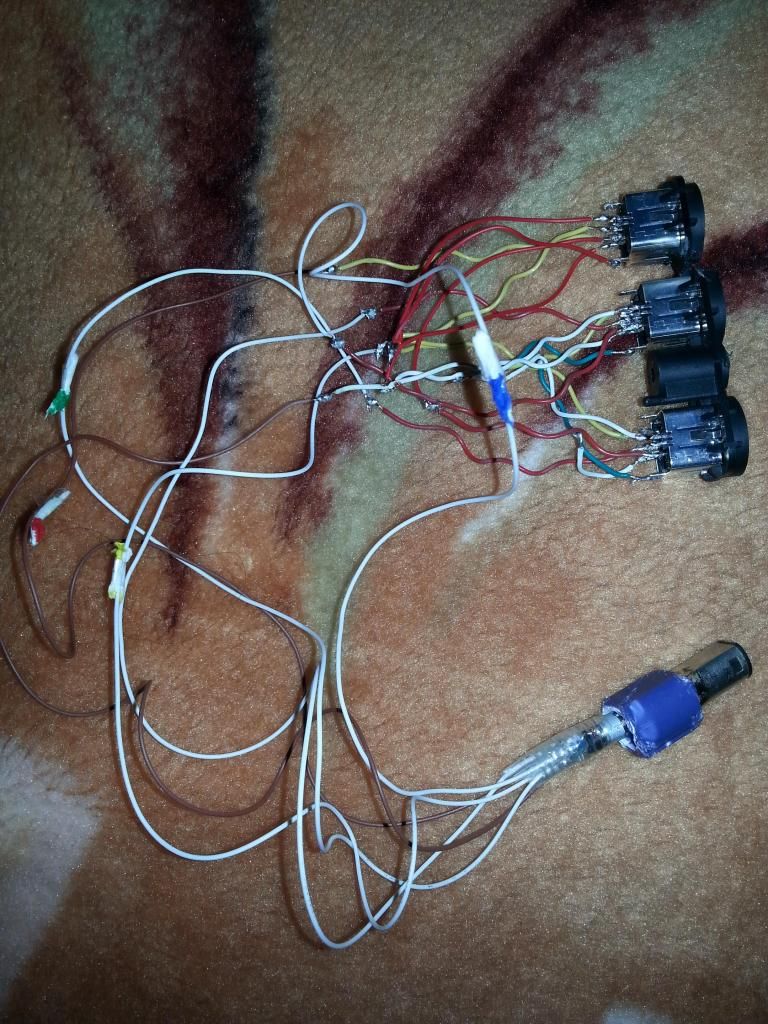

controller port for external p1 and switch
second controller port for player 2,3 & 4
fan speed switch
on/off switches for fans & screen
headphone jack
charging jack
stock heatsink
