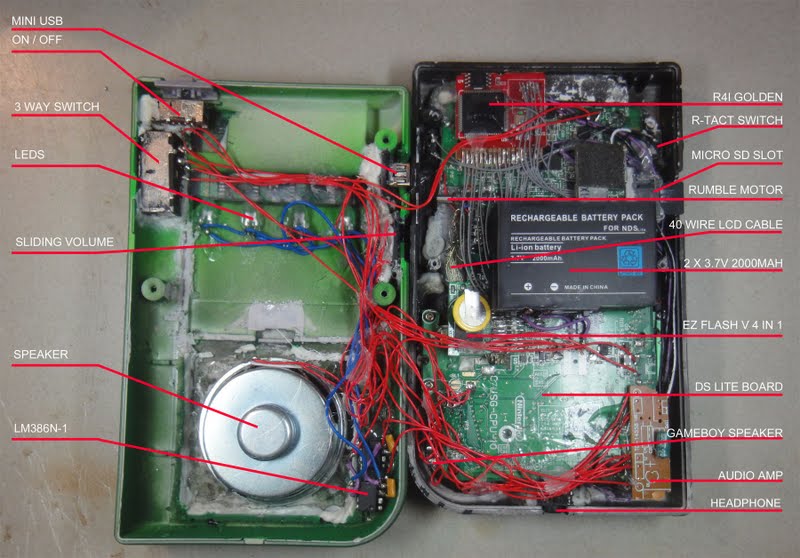

I found my old gameboy when i was searching for something in my storage. And thought, this old friend needs a second life!
So i upgraded its hardware, and gave it a nice paintjob.
And named it : Gameboy - Reloaded
This Gameboy can play any original gameboy and gameboy color games through emulation. It plays native non emulated all GBA Games.
And has many other emulators installed like : Nes, Snes, SMS, GG, PCE
Some Ds games can also be played witch dont use the Bottom LCD or touchscreen.
Specs/Features:
- Original Gameboy Classic (DMG) Shell
- DS Lite Motherboard
- DS lite Original 3.5" Bottom LCD
- 2 x 3.7v 2000 mAh DS Lite Batteries
- Battery indicator Green(ok)/Orange(charging)/Red(Almost empty)
- Original Gameboy Directional Pad
- Original Start and Select buttons
- Original Gameboy A + B Buttons and Custom X + Y
- Custom L and R (shoulder) Buttons
- Original Gameboy front speaker (mono)
- Custom 2Watt Speaker on the backside
- Audio Amp (mono)
- Gameboy Color Transparant Cartridge modded with 4 Bright Green sound reactive (stereo) leds
- 2 x LM386N-1 IC's for Sound to Led Effect
- Original Stereo Switching Gameboy heaphone jack (mutes speakers when plugged in)
- Mini Usb Charging Jack, Charge and play
- Original Ds lite slider volume controll
- 3 Way Switch for controll of flashing leds and backside speaker
- R4 dsi Golden with 16GB Micro Sd Storage, micro sd slot accessable from the side of the Gameboy
- EZ Flash V 4 in 1 Gba Slot device, Rumble feature, Full GBA support, Webbrowsing memory
- Matching bag with accessories
Original worklog can be found here : http://www.made-by-bacteria.com/viewtop ... =18&t=1322
