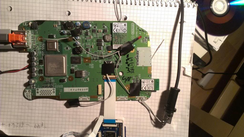

Last Sunday I trimmed my wiiboard, just a little of the shielding. I was looking at the top of the board making sure I didn't damage anything using a nibbler.
It went well untill i looked at the other side of the board where the nibbler had chrushed five components.
Yay me
The missings parts are:
TH3
C264
D14
C245
D9
I went and tried to turn it on, when I inserted 12v the red light lit up and when I pressed the power button it flashed green before it turned off.
The missing parts are all related to the power regulation.
I downloaded the datasheet for LV5044, which is similar to the LV5043 that's is the regulator on the wii and let my dad have a look at that. Yesterday he brought home some smd components according to the datasheet that we soldered on (it was a real pain, they are so tiny!)
No change when turning it on (still red light, green flash)

Is my board fried?
