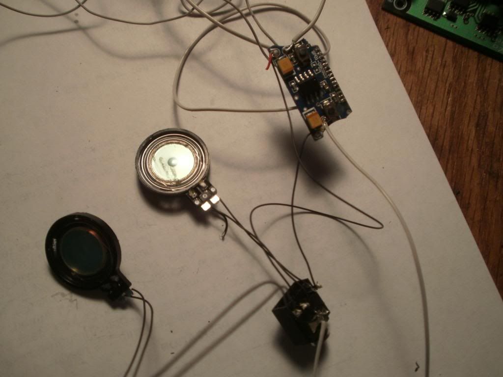

What speakers are you using? I'm using on mine a GBA speaker and I'm thinking of switching to a DS Lite one.
How many Watts are these types of speakers? Like 0.1?

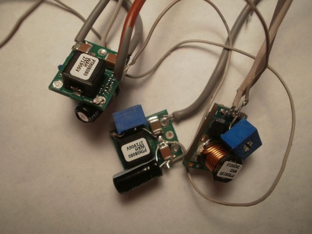

Managed to get some work done while procrastinating studying for exams :lol: . Wired up my batteries and modified the chargers case as it was meant for camcorder batteries and not embedded batteries. I just ripped it open and attached a cord to it, drilled a hole and called it a day.

Actually, they are the same batteries, I just tore mine out of the case. I might get a 4.3" or 5" screen depending on case size. I'm hoping to make this decently sized. Right now, I have DSi speakers hooked up to one of those godly ipod amps. I have no idea what the wattage of them is.

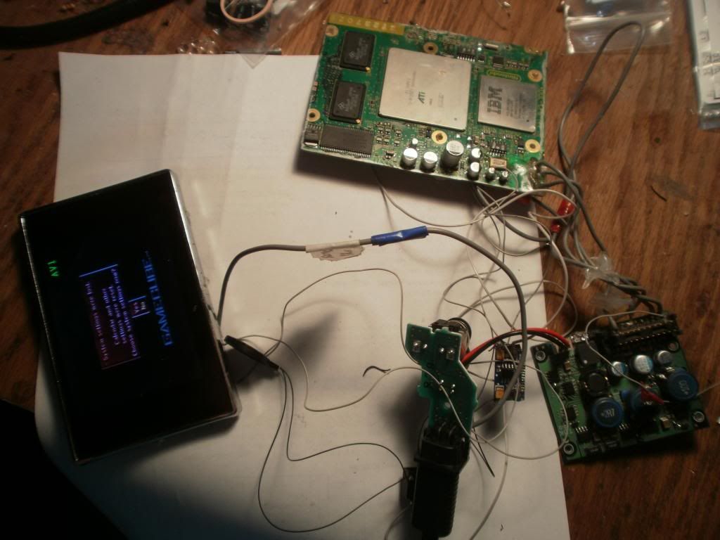

So, apparently the gamecube gods decided to hate me and fried my board for no noticeable reason. Then they decided to throw salt in the wound by making all three of my other cubes IPL 1.0. They must have been in a drunken rage last night because then they decided to say SCREW IT, LETS SHORT HIS BATTERIES TO. The end result being this pic.
That wire was the battery to the pcb, somehow it broke off its contact pad and shorted. Fair bit of smoke, and about half a second later that's what I was left with. The voltage of the cell that shorted is about 0.02 lower then the others, although that may just be my muiltimeter. I'm going to try and charge then up again and see what happens. Finally getting to the positive side, I made some progress with making the buttons for the controller.
I was using IDE wire just to test it on my screen, but after they shorted I swapped it out to 18 gauge. So, the PCB seems to be cutting the ground coming from the pack. I even traded out the PCB I was using for a second one I had. I'm going to guess that this means these guys are pretty much toast. I had built a set-up to try and test them out, but I guess that's not happening :roll:. Here's what they look like right now:
