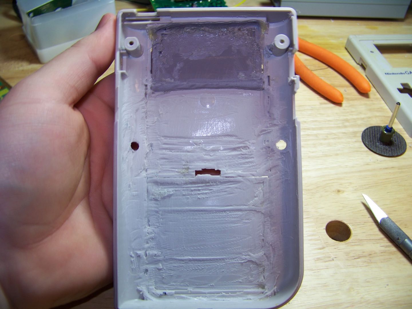

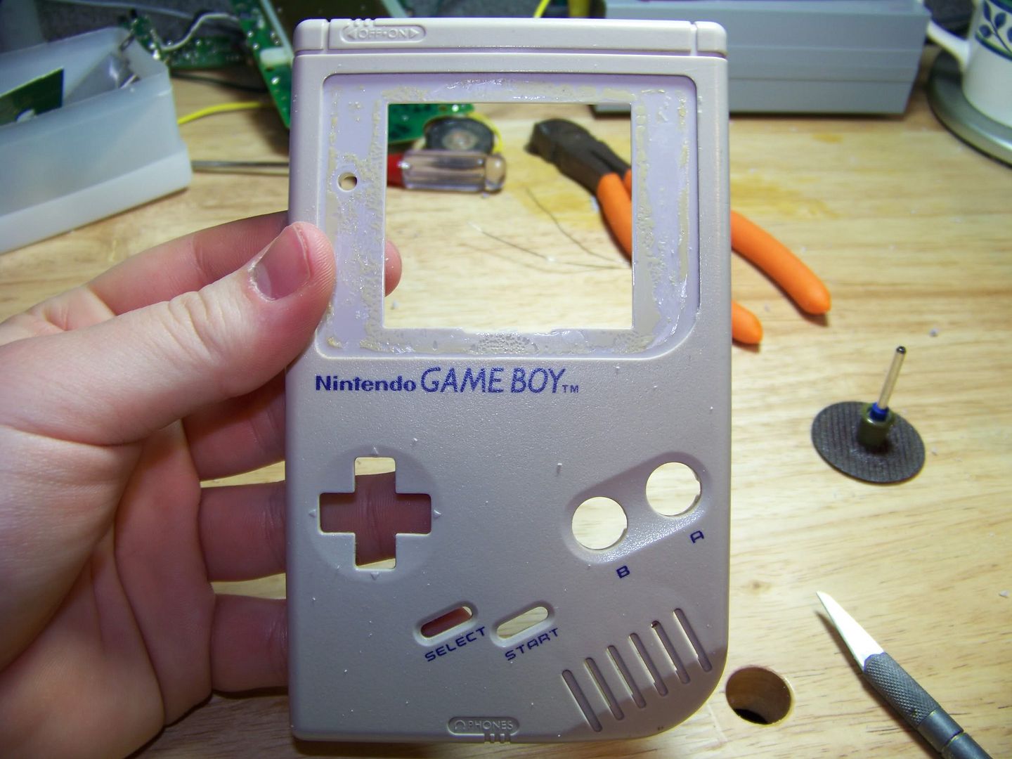

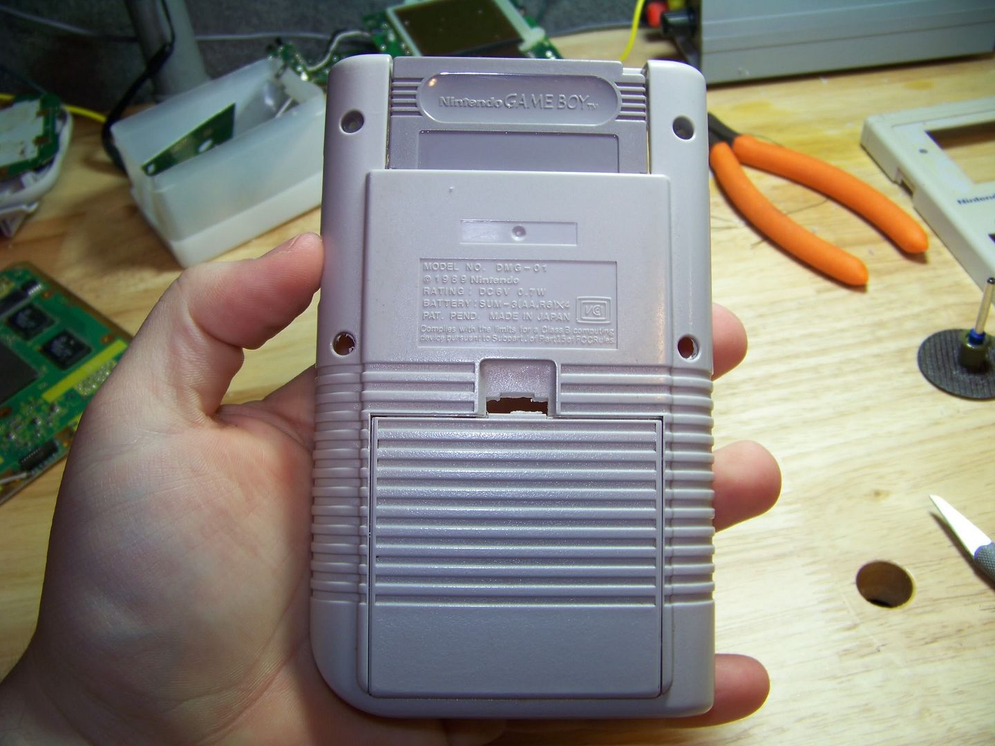

Now I know I said after the simple 64 I'm not using premade cases anymore but I'm making an exception for this one. It is a case made of nintendium after all.
The first work done on the case.
Epic big pics to start us off:
http://i73.photobucket.com/albums/i208/MNDOGYDUDE105/100_1487.jpg
http://i73.photobucket.com/albums/i208/MNDOGYDUDE105/100_1488.jpg
http://i73.photobucket.com/albums/i208/MNDOGYDUDE105/100_1489.jpg
http://i73.photobucket.com/albums/i208/MNDOGYDUDE105/100_1491.jpg
UPDATE *04/21/12*

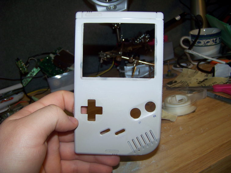

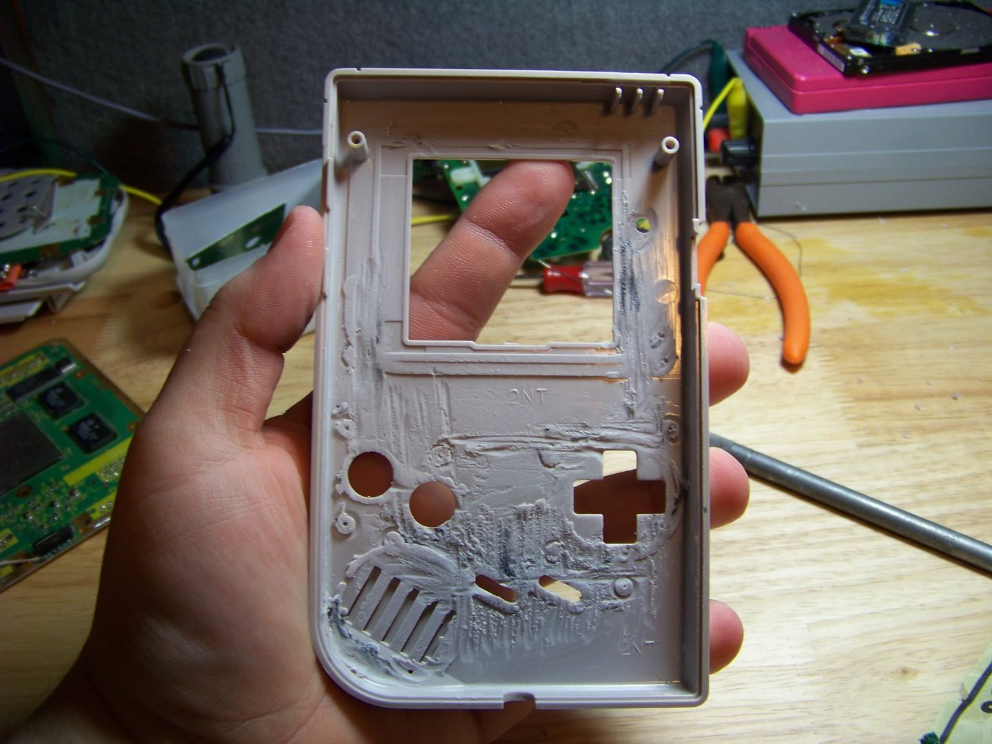

Minor update today. Got the screen cut and stuff. But needs more sanding and work done to make it perfect. My aim with this one is to make the case flawless. I'll be sanding down paint and air bubbles will be filled.

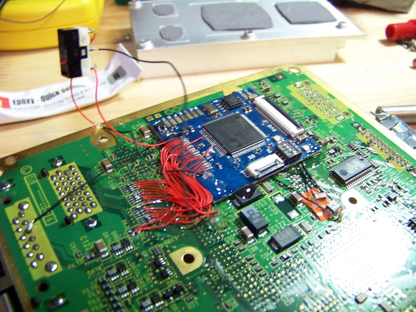

So I reached into my drawer and pulled out the first wiikey I bought. I've been planning to buy a new wiikey chip soon but because of the new EMU_kidid swiss flash firmware I really wanted to try it out. So after cleaning up the surface mount points for the FFC slot and after only 20 mins of wiring it was up and running. Turns out it works fine. So on to the flashing. I love the new swiss software, but now all I need to figure out is the auto button pushing circuit for the wiikey. So here's the stuff you care about. PICS! Nice and big ones.

I got a 3d printed extension from my school just before I graduated. It extends the gameboy case so there is adequate room for batteries. There would have been room for a gamecube without it. But IMHO it's just not a portable without batteries.
Other than that I got the new regulator wired up and new parts in for building the automatic wiikey switch. (more on that in a future update after it's been built) The board has been cut almost completely. The only part left is making the cut of the transistors for the cube controller. Which I think is going to be the hardest part, I just don't know what the transistors are for so I'm walking into this cut blindly. A lot of research is in my near future. Anyway: PICS!

Alright everyone now for some actual progress, I wired up an SD gecko, and a 128mb memory card. I also added the clock battery and flashed my wiikey with autoboot firmware. Everything is going well, the next step will be doing some casework and cutting down the controller. And finally some pics!

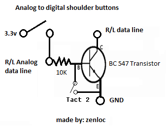

I use zenlocs guide for a single push button trigger. And I use a second tact switch that shorts the signal to ground so it ignores the right and left tact data line.
I do this basically.
The transistor does not come on and you can press the trigger all you want without fully depressing it.
