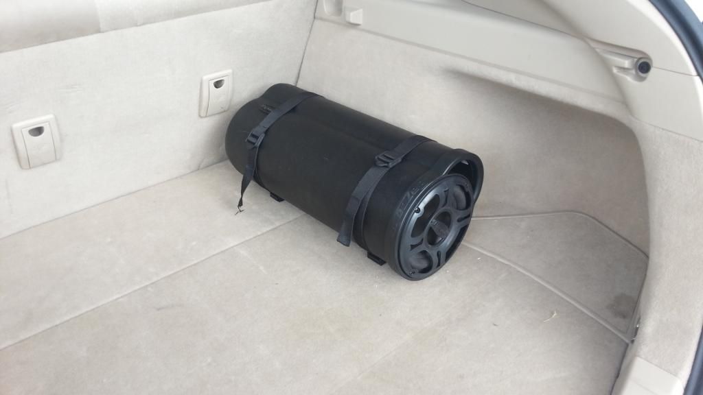

I have a Bazooka tube w/built in amp in my Prius, doesn't take up too much room. Its a "250w" (uses a 15A fuse on a 12-14v line...). It does a decent job filling the bottom end, but its definitely not a window rattler. They're pretty spendy, though, I've heard good things about some of the flat sub boxes that are about half the price.

My headunit has dedicated sub pre-outs that I used. The Bazooka has a built in crossover that's adjustable and can use either pre-outs or speaker level input. Power cables were easy, as the Prius' battery is below the floor on the right side of my picture, so I didn't have to deal with the firewall. I ran the audio cables through the dash and then back under the plastic along the floor of the door frame. I thought it was pretty easy, but I've done some similar stuff before.
