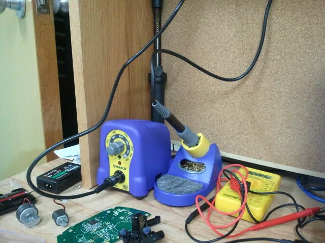

Little update.
I bought the Hakko FX-888, and other than the Playskool color scheme, I can find no flaw in it. Definitely something to look into if you have the cash and want something a little more professional.
Behind it is the solder sucker I linked to in the first post. Could probably suck a golfball though a garden hose. Like the iron, a must have if you can afford it.
i have a Hakko FX-951
that FX-888 looks to have the same specs except for 5watt consumption difference....
not sure if that one has a sensing circuit in the stand to cool down the iron when not in use...
i almost bought a Weller WD1001, at the time they were over 500$
got the Hakko used on ebay for 150$ and never regret that decision...
those Hakko's are really good and on par with top dollar weller irons...
dont worry about the Playskool color scheme...it will grow on you..
good choice, you will love the Hakko
