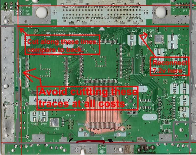

the gray lines is where I trimmed my board the problem is the dark red line is where I messed up at is there a way to fix this if so let me kno :tophat: thanks
Really easy to fix in fact, just compare your board to those scans: (top and bottom)
If you cutted through traces that you shouldn't have, you only have to scratch the light green trace with a knife or something to reach the copper each side of where you cutted, than solder a wire from point A to point B than tadam! You just repaired the trace with a wire instead of the original copper trace.
If you scratch the green enough it's suppose to stick, just try to heat that part of your board with your soldering iron before trying to solder.
