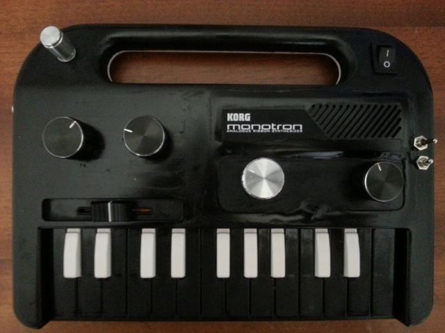

I have been lurking portablising forums since benheck, and i never had the time, the resources nor the tools to build one of these bad boys. In the meantime my interests changed, so while this isn't technically a portable console, it uses various techniques learned here, so i figured i'd give a bit back to the community.
Here it is:
Monotron k
(k stands for klavier, or special k, if you're into that kind of thing)

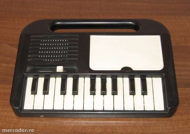

Now for a little back story. I got the monotron a couple of months ago, and if you've ever played with the thing, it has some awesome sounds, thanks to the original ms 20 filter (well technically half of it, since there's no high pass, but nevertheless). It only had a ribbon controller and a pitch potentiometer, which means you couldn't really use it for playing live, especially with other instruments. So i decided to integrate it into a toy piano keyboard, one of those oldies which had a resistor ladder.

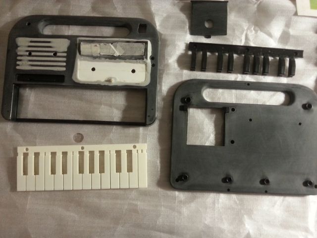

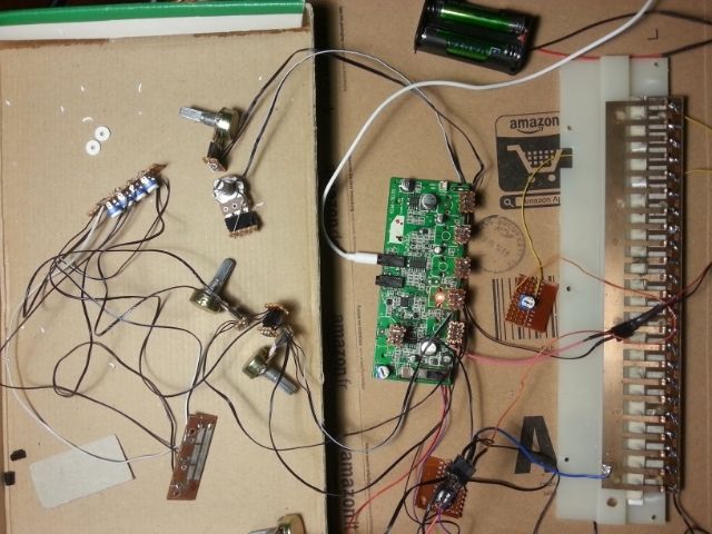

After i disassembled it and switch the different resistors with a constant one (100k), i went back to the monotron and took out all the pots, replacing them with connectors:

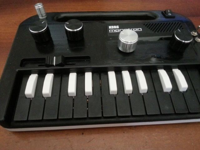

I decided to frankencase the upper part of the monotron into the case, to preserve some of the style and the original writing:

testing everything

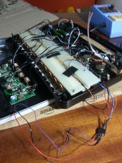

putting it all together (careful now, it's tightly squeezed)
And that's pretty much it. I haven't done any mods except lfo to eg (i plan on building an expanding module of sorts, adding a pulse wave from the monotron's saw and a couple of sub oscillators, using comparators and dividers, but that's for another time)
Some more pics for your enjoyment
That's about it. Tell me what you guys think

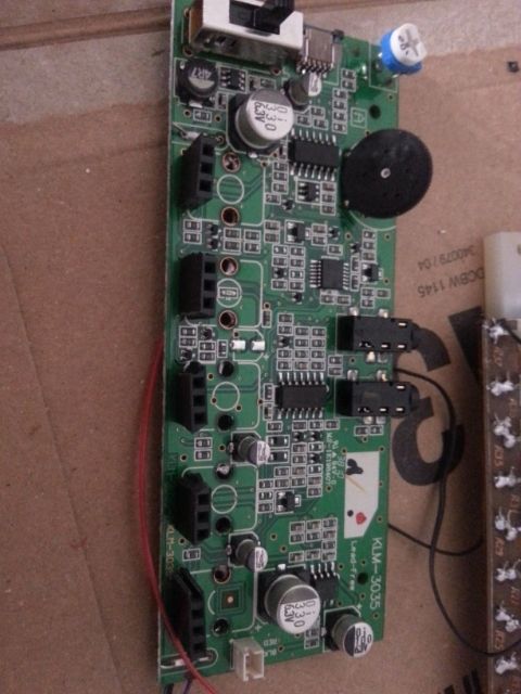

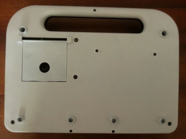

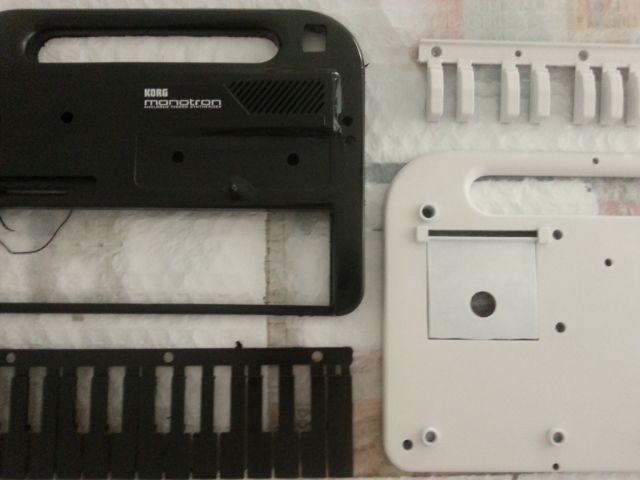

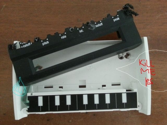

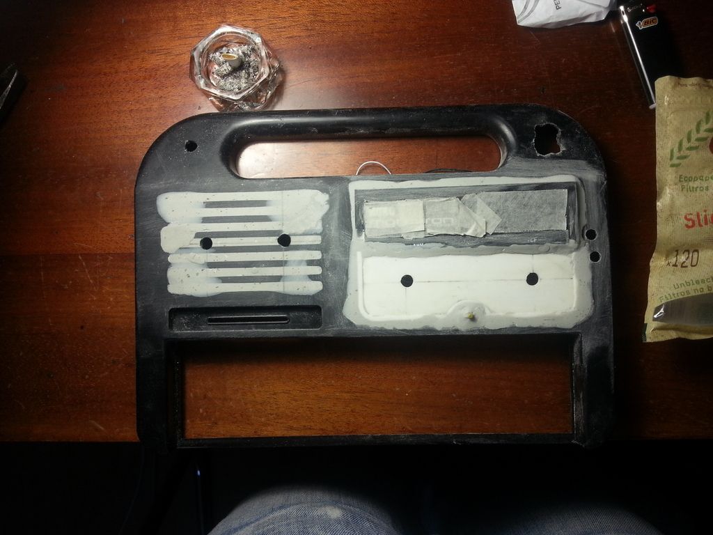

crimes against consumerism..
testing everything

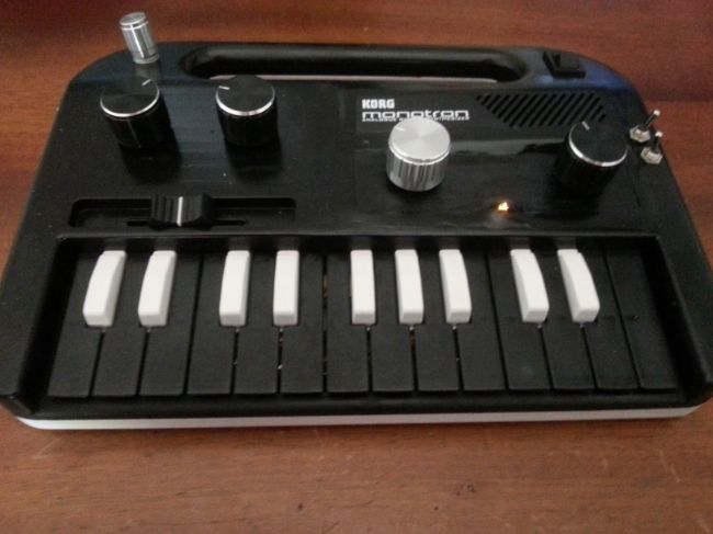

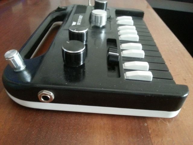

before spray painting
after spray painting
