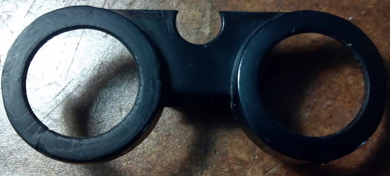

I started working on the controller today at 9 am and by 6 pm (9 hours later) this is what i have:
djbQGb2Kq67vCLyQQAGkrWSh0fiIvZihTpqXKfqhXE0=w800-h684-no
2_i8rR-JjinTkGYZ8X7n-O7Lo4tH_BPeA7Eg2F2QLoc=w800-h629-no
So i almost have the "Bodywork" part i'm still trying to figure out how to put the L, R buttons, i was thinking on a pair i have from an xbox s controller, take out the potentiometer and put a push-button, the electronic part will be the easiest, because is only jumping wires one side to the other, im also putting speakers on it, i have this little amplifier boards which come inside some Gateway desktop pc, you put 3.3~5v trough it and it outputs 2~3 watts, and i have some speaker laying around. and i want to paint it two, but that will be later. im pretty confident it will be finished the Saturday.
