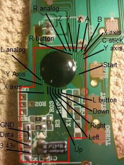

Does someone have a pinout of a ebay third party controller? I swear I saw one around here but I can't seem to find it.
Edit: Also,a link to some NC tacts would be awesome.
I think that this is what you're looking for?
(credits to bugman)
Just letting you know, not all 3rd party controllers are the same. Make sure you double check everything on the board. I think you're better off tracing it yourself.
This is the pinout for the gamecube controllers on dealxtreme/most of the third party ones on ebay so the pinouts should be the same
