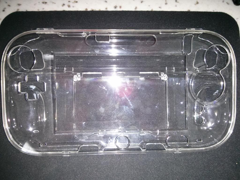

SO, to get started off, I have chosen a Modified Wii U Gamepad as the case for my system. I wanted to stay true to the 4
output of the Gamecube so I am using a 5" Zenith screen. I plan to remove (At Last Calculation) about 1.5" for the center of the Gamepad Case to accommodate the screen. The controls will be "bondoed" in. I am still unsure whether I want to use two tact switches for the L and R or I have an old MadCatz controller with rotational pots on the L and R (I believe it is the same as what Tchay used in his Envision). I believe the audio amp is handled by the screen as well as a switching headphone jack. I chose to use the Original Regulator as when I tried to get a sample of one of the Custom Regs, the quantity came up as zero... and I didn't want to go though the hassle of getting in touch with TI Customer Service to get Samples of the Regs. I still have to figure out a 12v-7.4v conversion for the screen however.
