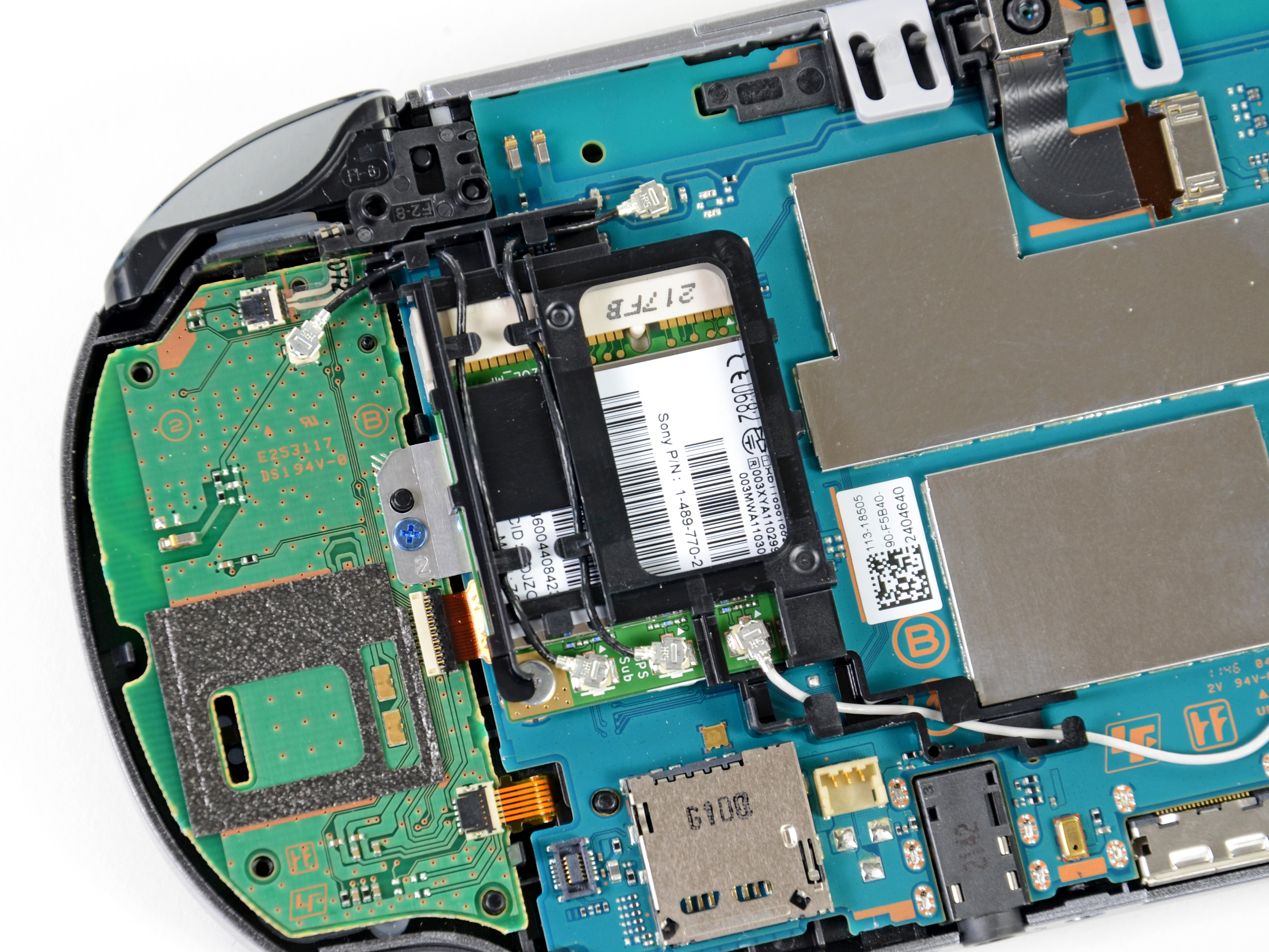

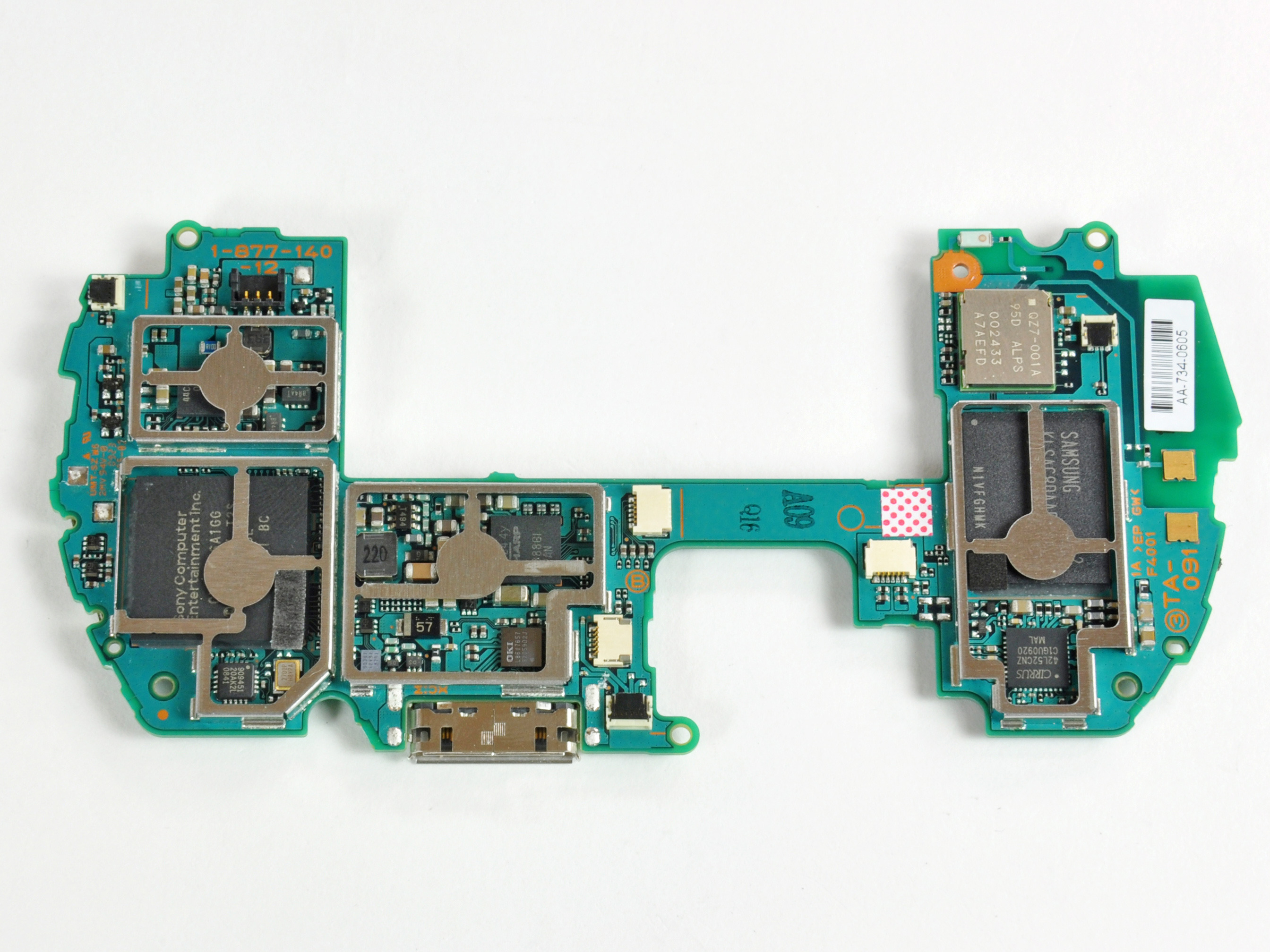

PS VITA
The best pictures I could find were the ones from the ifixit website
https://d3nevzfk7ii3be.cloudfront.net/i ... wE51rIAPQd
https://d3nevzfk7ii3be.cloudfront.net/i ... ipGo5Ib2ki
https://d3nevzfk7ii3be.cloudfront.net/i ... XsoNdxIgHf
the second one is the best, though there is a black thing blocking the view of the traces :/

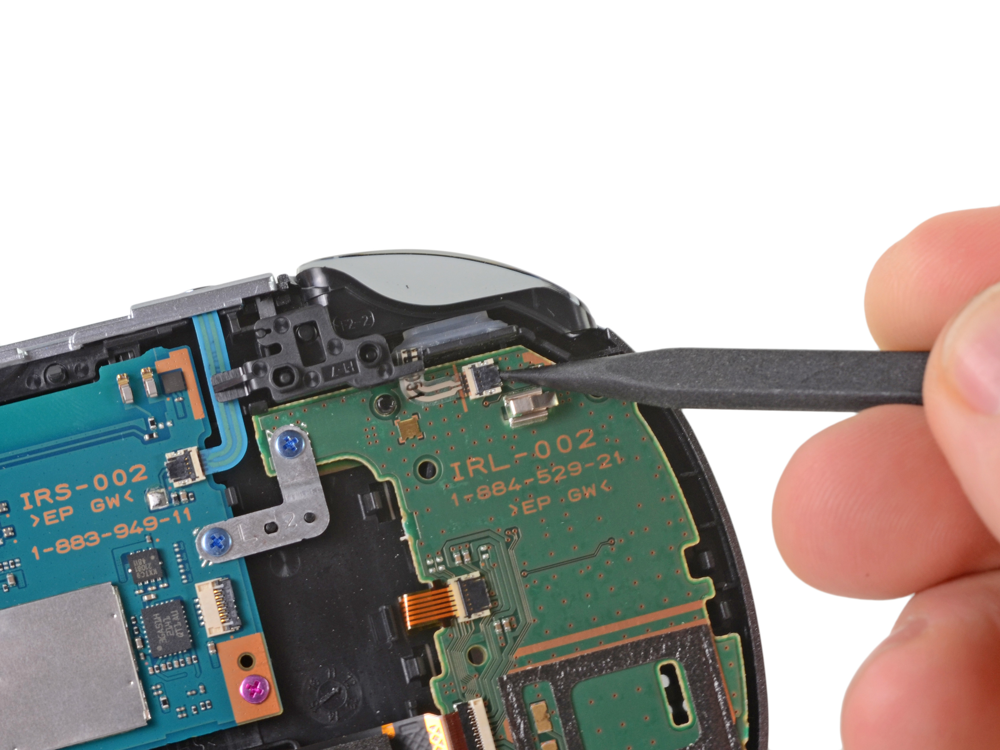

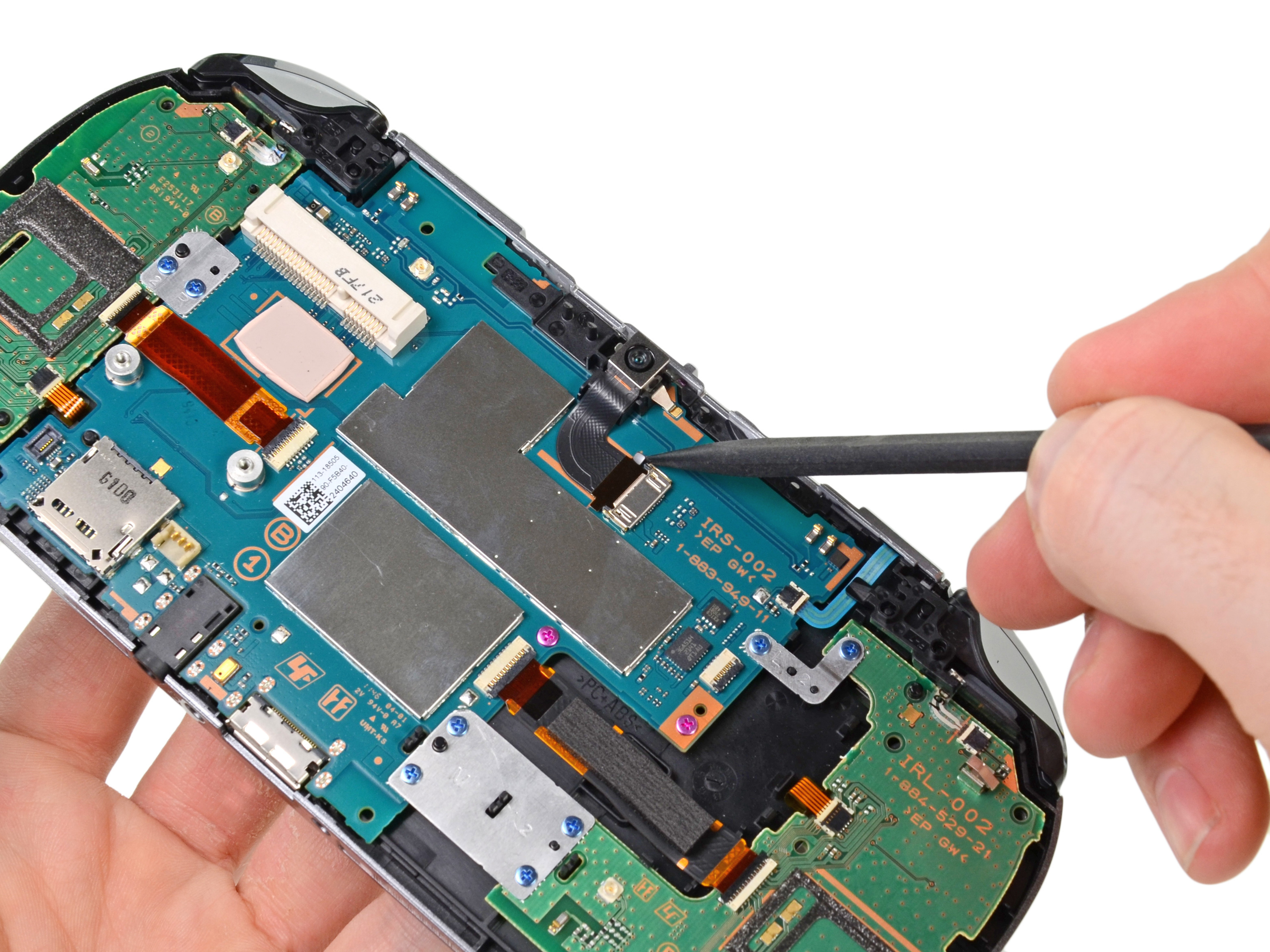

EDIT: here are 2 more pictures. They show the connections between the stick and the left button PCB, and the mother board
http://www.consolesandgadgets.co.uk/cat ... _Board.JPG
https://d3nevzfk7ii3be.cloudfront.net/i ... X1nupBChOj

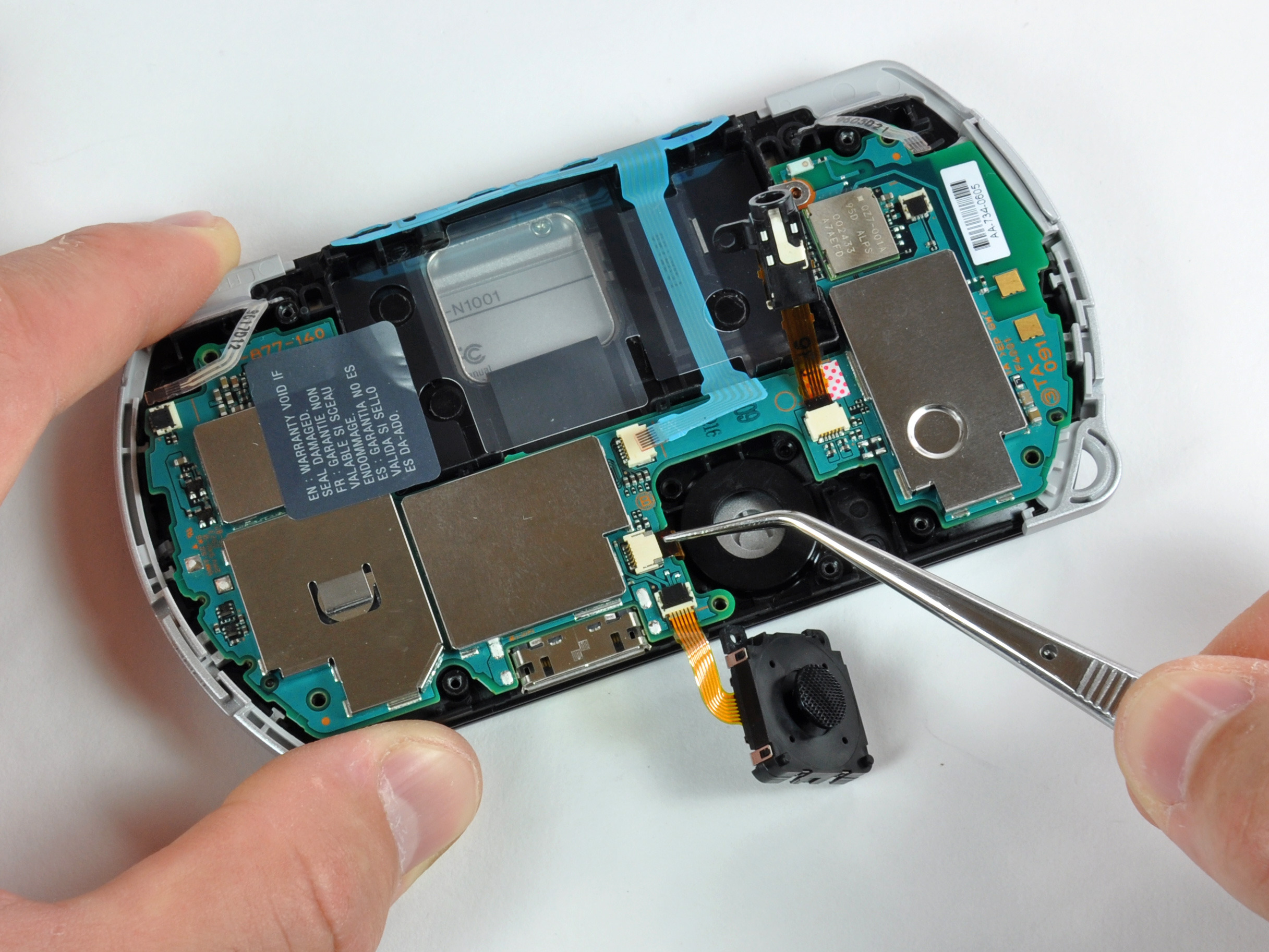

PSP GO
what's weird about this is that it looks like it's only using 4 of the 6 pins
https://d3nevzfk7ii3be.cloudfront.net/i ... TqhD2vmjPP
https://d3nevzfk7ii3be.cloudfront.net/i ... sBeRsB5wqP
