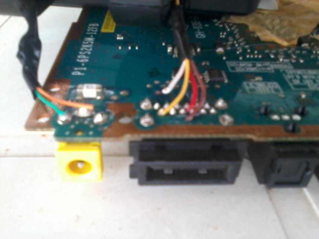

On the screen I want to incorporate in ps2

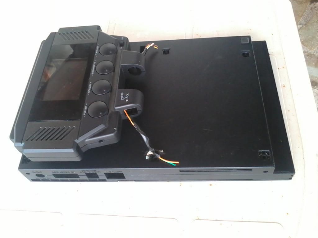

The end result will be so.
Will stick to the screen in ps2, will join the cable internally to board ps2.
I want to make a ps2 portable.
